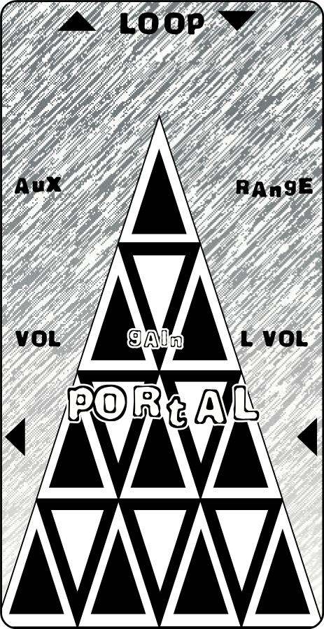

Postby autopilot » Sun Jan 29, 2012 6:10 pm
did the artwork today, just waiting to finnish the pcb, to label the knobs :!!!:

Re: molecule inspired fx loop (Portal)
Postby autopilot » Sun Feb 05, 2012 3:13 pm
Here's a sneak, this will be available under another brand (kinda like a side project). That i need to get a domain, and create a website
